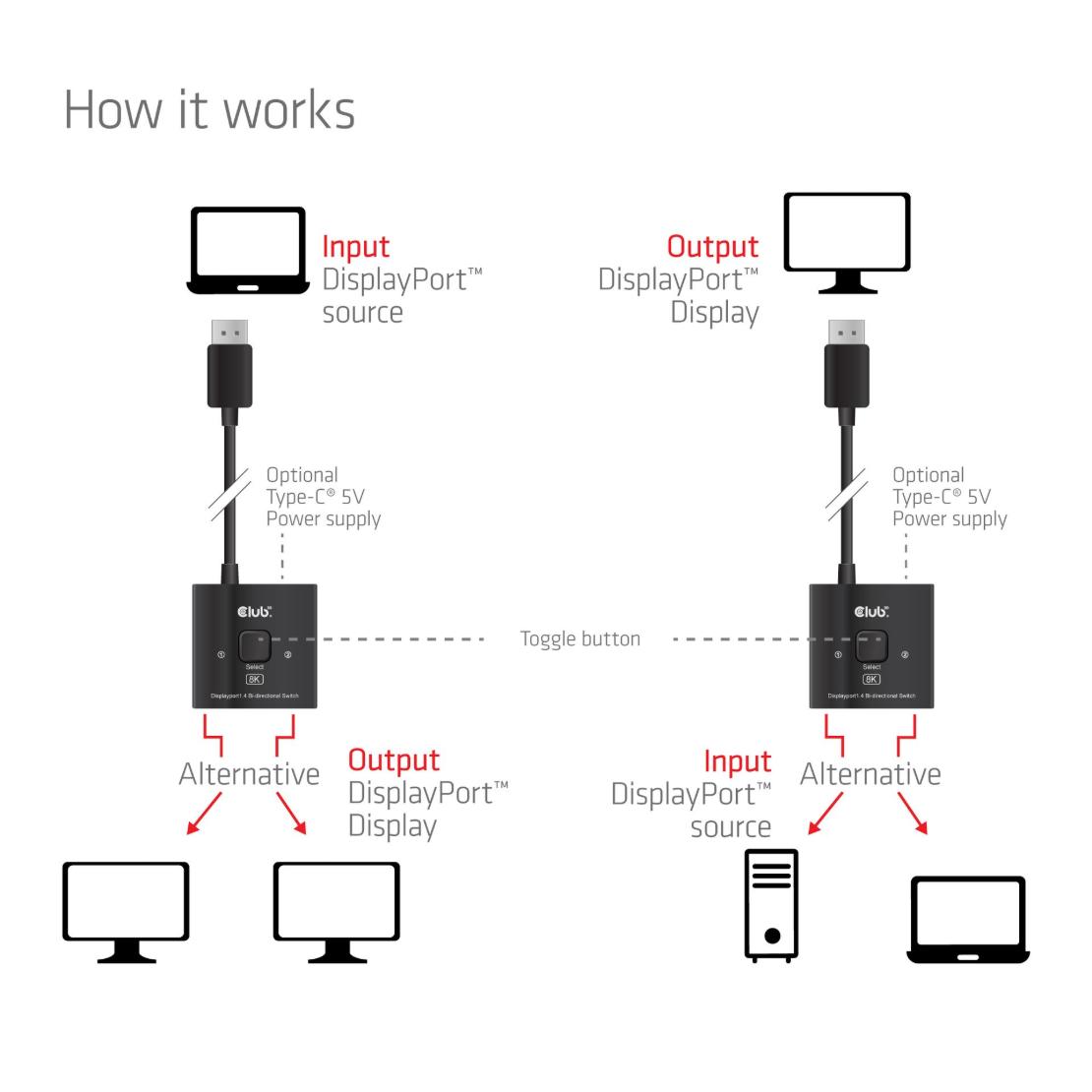

Connection Procedure
Choose Your Setup
Before connecting the product, determine which configuration you need.
Option A – Two Sources → One Display
Use this option if you want to share one monitor between two systems.
Typical use case:
Work laptop ↔ Home PC → One monitor
Option B – One Source → Two Displays
Use this option if you want to switch one system between two displays.
Typical use case:
PC ↔ Monitor or TV
Only one source or one display can be active at a time.

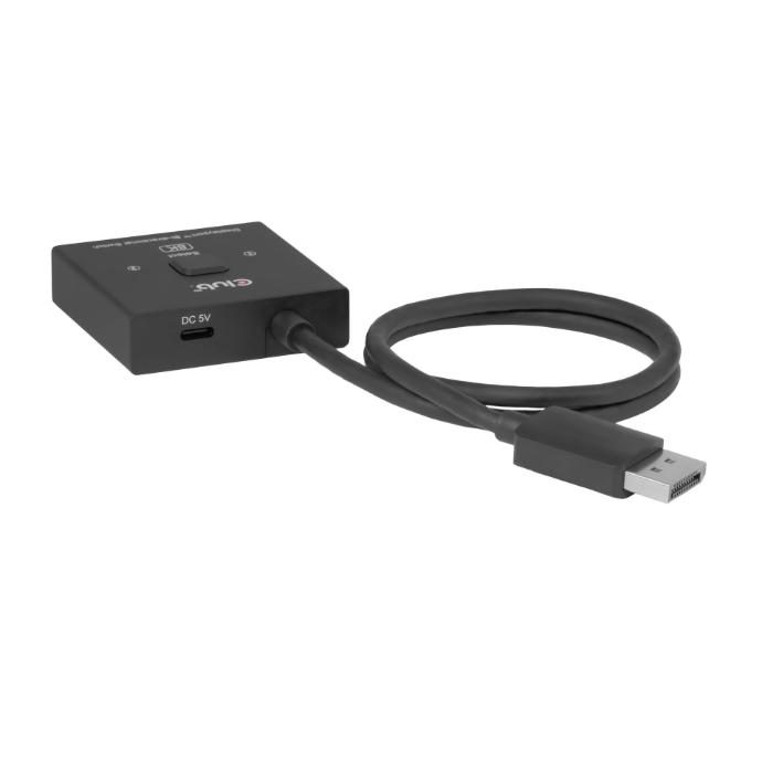

    The CSV‑1009 is normally powered directly via the connected DisplayPort™ device.
    If you experience:
    No signal
    Unstable switching
    Display flickering
    Connect an external USB‑C® power cable to the USB‑C® female port on the device.
    External power improves compatibility with low‑power source devices.
