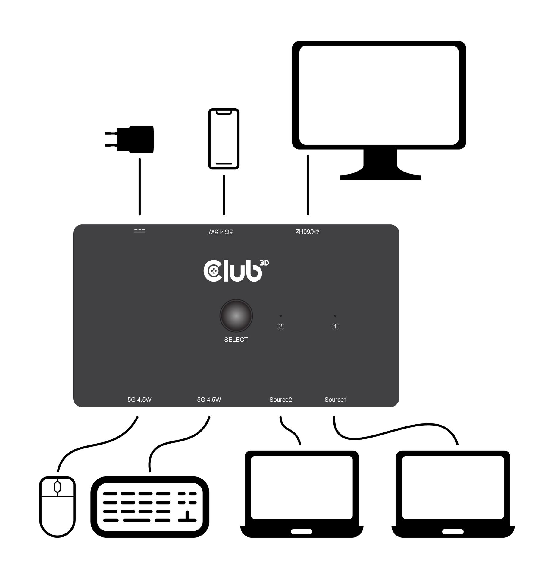

Connection Example: Two USB‑C® Hosts to One HDMI™ Display
This is the standard KVM use case.
- Connect Host System 1 to the USB‑C® port labeled Source 1 on the CSV‑2512.
- Connect Host System 2 to the USB‑C® port located near the USB‑A ports (Source 2).
- Connect the HDMI™ display to the HDMI™ output port on the CSV‑2512.
- Connect keyboard, mouse, and other USB peripherals to the USB‑A ports.
- If host charging is required, connect a USB‑C® Power Delivery adapter to the USB‑C® PD charging port.

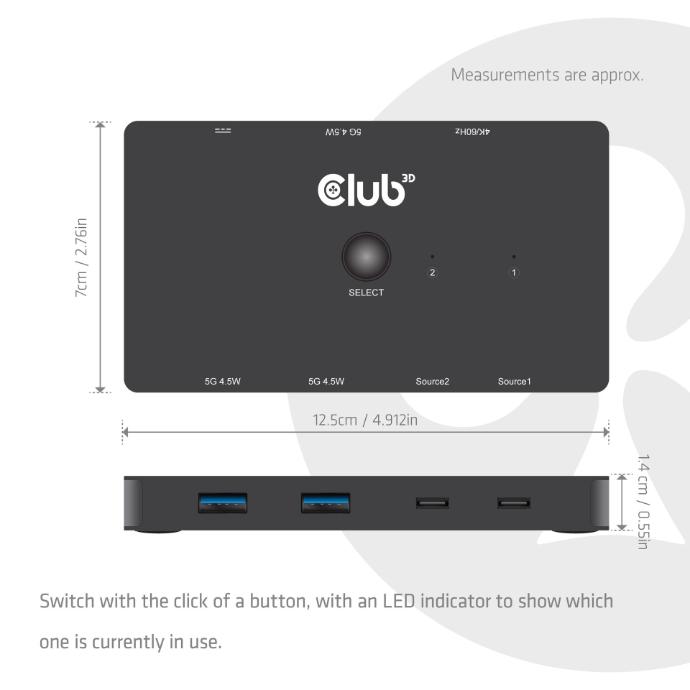

Switching Between Hosts
- Press the Select button on the CSV‑2512 to switch between Source 1 and Source 2
- The LED indicator shows which host is currently active
- The active host controls the display and connected USB peripherals
