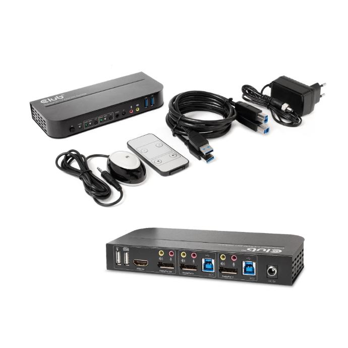

Package Contents
  • CSV‑7210 KVM Switch
  • Power Adapter (5 V / 3 A)
  • IR Remote Control
  • IR Extender
  • USB Gen1‑B to USB Gen1‑A Cables ×2

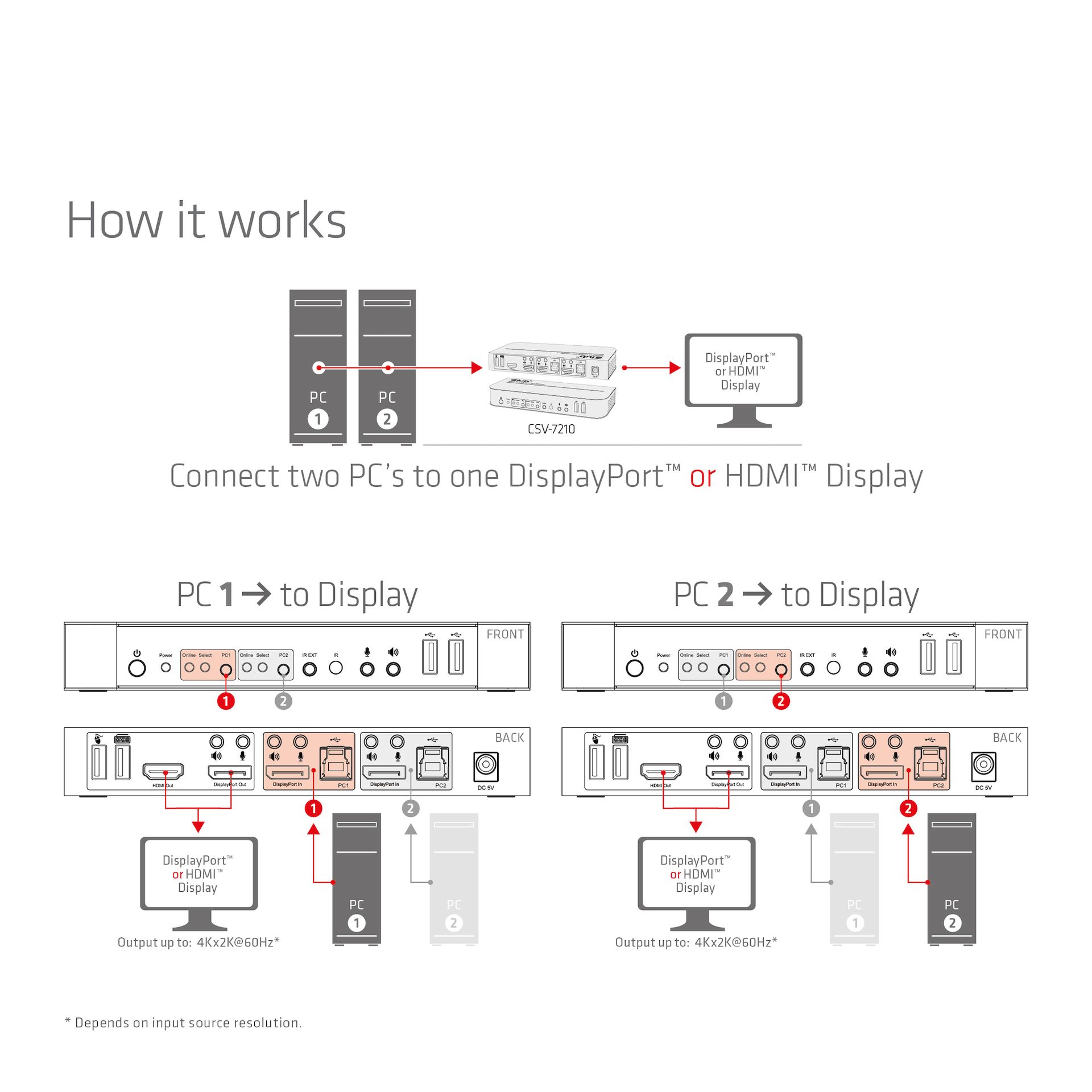

  • PC1 / PC2 Inputs
    • DisplayPort™ input
    • USB‑B input
    • Microphone input
    • Audio output input
  • DC Power Input
    Connect the supplied 5 V power adapter.
Connection Instructions
  1. Connect the USB‑B, DisplayPort™, and audio cables from PC1 to the corresponding PC1 input ports on the CSV‑7210.
  2. Connect the same set of cables from PC2 to the PC2 input ports.
  3. Connect one or two displays to the DisplayPort™ and/or HDMI™ output ports.
  4. Connect keyboard and mouse to the USB ports on the KVM switch.
  5. Connect speakers and microphone if required.
  6. Connect the 5 V power adapter to the DC input and power on the unit.
