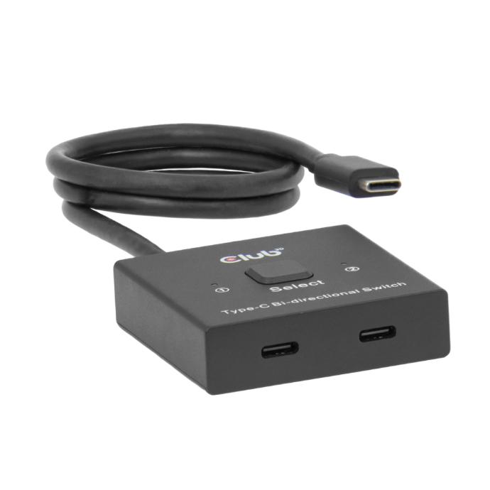

Thank you for purchasing the CSV‑2511 USB‑C® Bi‑Directional Video, Data, and PD Switch.
Package Contents
  • CSV‑2511 USB‑C® Bi‑Directional Video, Data, and PD Switch

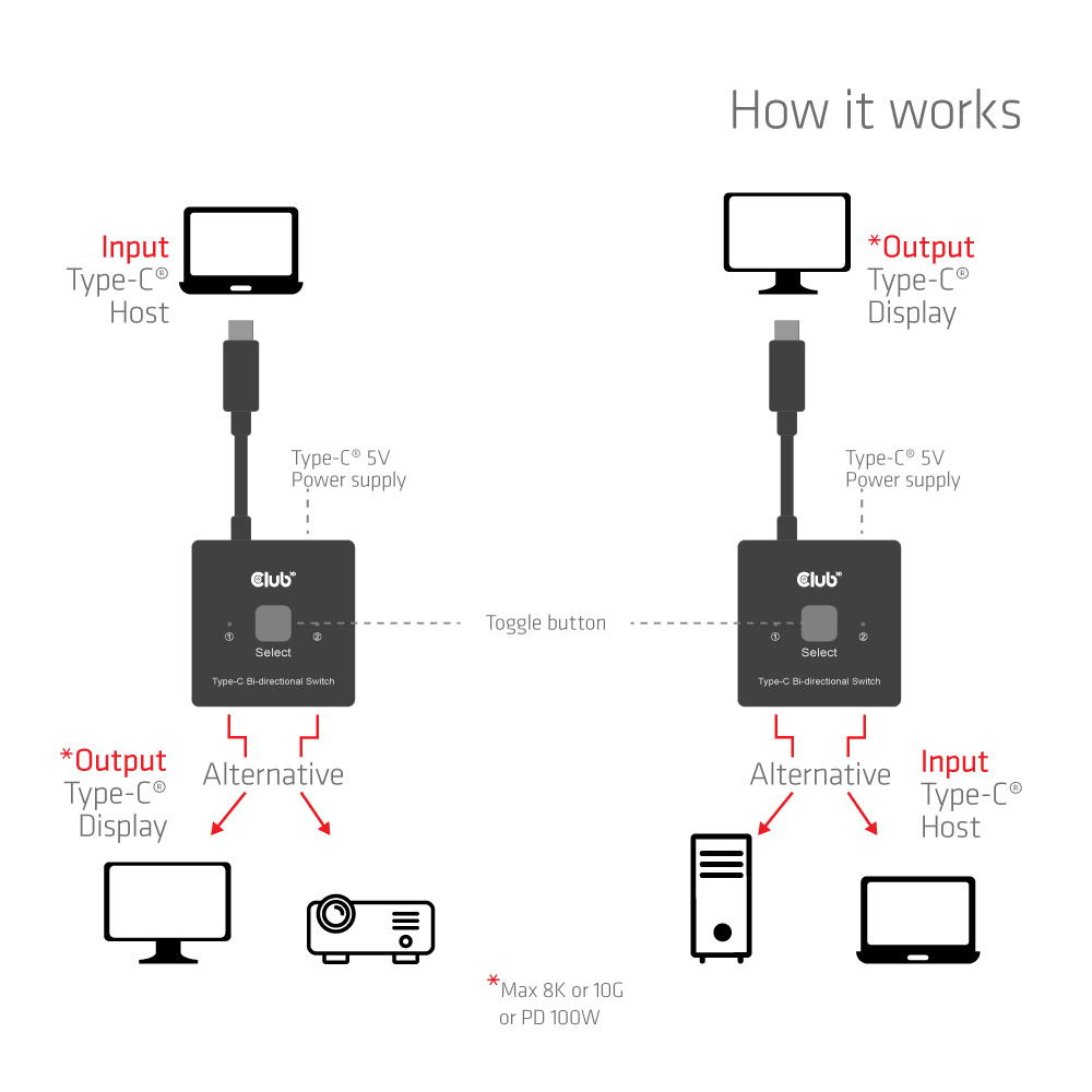

The CSV‑2511 is a bi‑directional USB‑C® switch, allowing flexible switching in two possible configurations:
  • Two USB‑C® source devices to one USB‑C® display, or
  • One USB‑C® source device to one of two USB‑C® displays

  1. Decide whether the CSV‑2511 will be used as two sources to one display, or one source to two displays.
  2. Connect the USB‑C® source device(s) and USB‑C® display(s) using USB‑C® male‑to‑male cables.

When powered, the switch defaults to Channel 1.
  1. Press the switch button to select the desired channel

The CSV‑2511 requires external power to operate.
  1. Connect a 5V USB‑C power source (adapter or powered USB‑C port)
  2. Connect it to the POWER USB‑C® port on the switch
 Without external power, the switch will not function, even if PD is present between host and display.

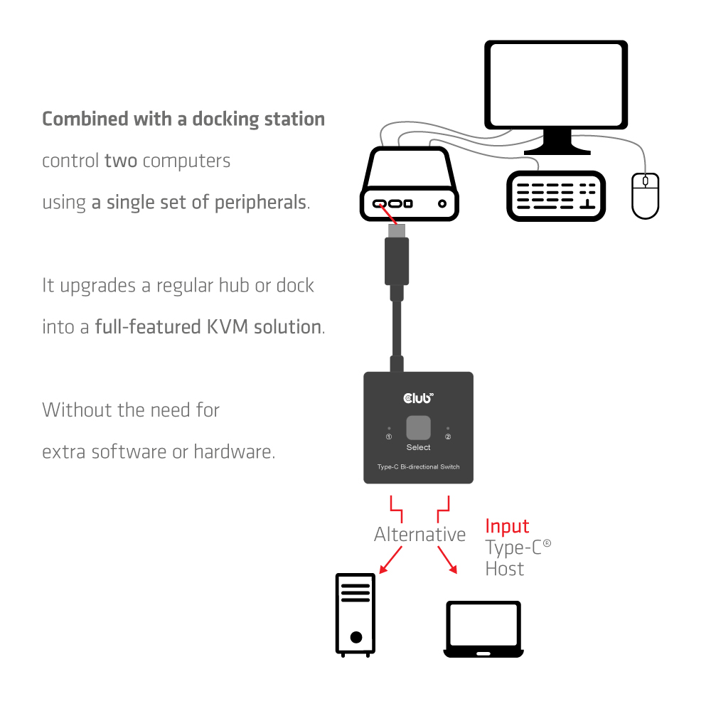

Example 1: Two USB‑C® Sources to One USB‑C® Display
This setup allows two computers to share a single USB‑C® monitor.
  1. Connect Source Device 1 (for example, a laptop) to USB‑C Port 1 on the CSV‑2511.
  2. Connect Source Device 2 to USB‑C Port 2 on the CSV‑2511.
  3. Connect the USB‑C® display to the remaining USB‑C port on the switch.
  4. Power on all devices.
Use the switch button to choose which source is currently connected to the display.
B. One USB‑C® Source to Two USB‑C® Displays
This setup allows one computer to switch between two different USB‑C® displays.
  1. Connect the USB‑C® source device to the center USB‑C port on the CSV‑2511.
  2. Connect Display 1 to USB‑C Port 1.
  3. Connect Display 2 to USB‑C Port 2.
Use the switch button to select which display is active.
