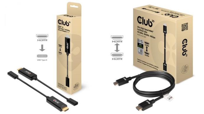

Box Examples
Left: HDMI signal converted to a USB-C port  Right:HDMI to HDMI - straight signal no conversion.
